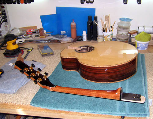

Lance, I use a mortise and tenon joint, but the mortise is on the top of the guitar and the tenon in under the fingerboard extension. Here's a photo.
This neck design is "heel-less" but I use the same joint on a traditonal neck with 1 additional bolt through the neck block. The mortise & tenon joint remains the same.

Jimmy,
Would it be possible to see more pictures of your neck joint? I need to see a few more close ups to really understand how it all fits together. If you can that would be great!
Thank you.
Jeff
